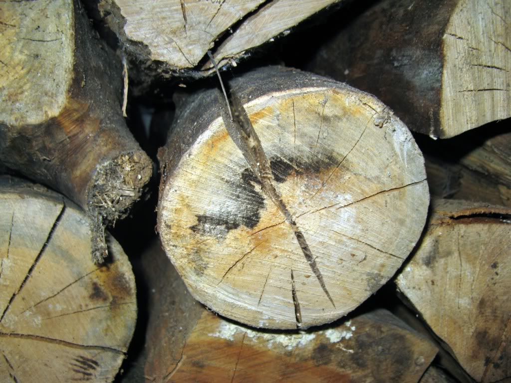

I don't give a poo what the moisture meter says, look at the wood and make a judgment, split a piece and feel it against your cheek and make a judgment, if if you still aren't sure then it's not ready to burn.
I just left a post about this in the "wood shed" https://www.hearth.com/econtent/index.php/forums/viewthread/69172/
Here's a pic from that thread. Dry wood (whatever the heck the % actually is) should look along the lines of being ready to split in 1/2 on their own.
