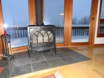

My stove is in front of glass doors. Works great - enjoy the fire and the view at the same time. Plus the hot stove counters the coldness of the glass.
- Rich

I just measured ours and it is 32" from the nearest point of the stove to the door handle.

Please allow me to be the fist to type.... WOW!...Great view!
Very nice Catspaw!

Thanks for all the replies. Got the 36" from a maine.gov website, guess its off or I read it wrong. Catspaw, that looks great, and similar to what my in-laws are going for.

That is gorgeous Catspaw!
