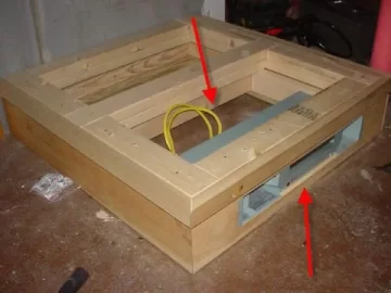

Hi all,

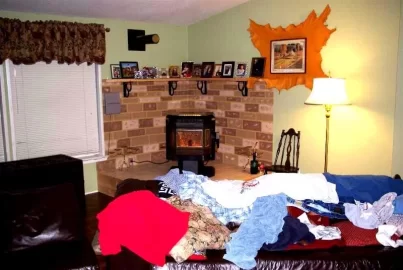

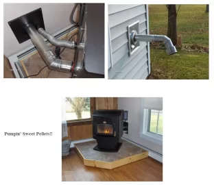

a month ago I was asking a zillion questions about hearth building. Well, I've been plodding at it and I'm now up and running.

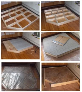

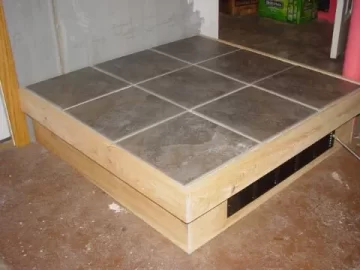

Hearth build: 2x4 framing with 1/2" plywood on bottom, layer of 3/4" plywood on top, 1/2" hardiebacker board then layer of porcelain tile.
Hearth dimensions: 53" long sides, 37.5" short sides and the angled front is 20.5"
Thanks everyone for all your help and suggestions!
Nancy
