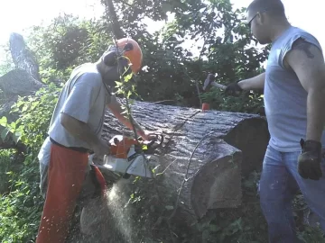

Never seen sparks fly from oak, my bet is on junk in the tree!
Come on down. One is standing there waiting that will shower you with sparks. And trash any chain ya got. Bark off standing in the sun and the bugs don't get a foothold and white oak is like petrified wood.
I'm saving it for ya.
BrotherBart said:
If I lived closer,I'd grab it.If its sound,I dont leave it in the woods.No matter if its 4 inches diameter or 34.Sometimes takes me a while,but it all gets cut & hauled in eventually.Too good to let go to waste.

BrotherBart said:
You got it, No smoking may catch the saw dust on fire.....Bet I can run sideways with out throwing sparks. ;-)
