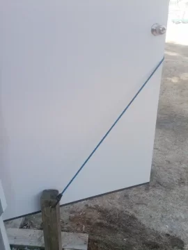

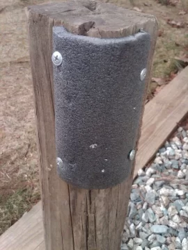

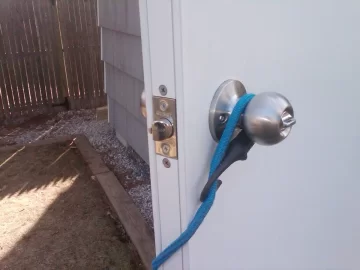

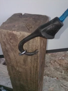

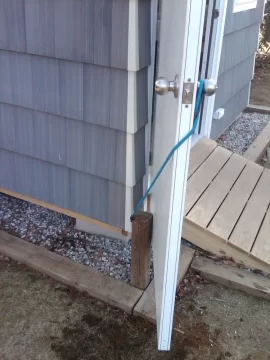

DagNabit, that old shed door was flapping away again! Well no more!
I got a 3 foot PT 4x4 and buried half in the ground so the door would not hit the shed and pull on the hinges, then screwed in a cup hook and hooked up an old bundgy cord to the door handle and cup hook!! Works great! See pics Below
