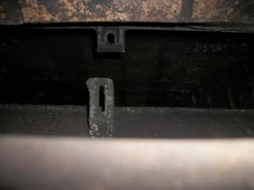

So my 6 inch liner is in transit. But if you look at this pick of my existing exterior fireplace youll see that smack dab in the middle are 2 pieces of hardware left behind my the damper that I removed. They are 15 inches from where the top of my Buck 21 will sit. So Im wondering if I will be able to dog leg over around these things and still be able to come back to center to tie in to the stove? I just dont kmow how flexable these things really are. I like things perfect btw.
I also will have practically no top clearance to work with, maybe 2 inches, but I can get my arms in through the sides between the stove and the sides of the fireplace. Yet Im wondering now whether or not that will be enough room for me to make my connection to the top of my stove and seal the connection. I can order 3 inch legs from my local dealer but would rather not if I dont have to. Thanks fellas, esp BrotherBart who helped me through this entire experience.
