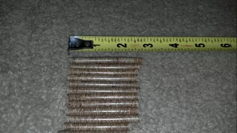

    You want long pellets? These are loooooong pellets !!!!
  21. djs_net Member
    joined: Nov 25, 2011
    178 posts
    CT
    What brand are those?
  22. DexterDay Minister of Fire
    joined: Dec 11, 2010
    9,055 posts
    NE Ohio
    Those are AWF's from 3 seasons ago. But I have since bought them afterwards and had Zero problems.
