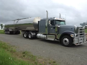

    It's 16 cords, not face cords. I am putting a boiler in my truck garage. Between my house and garage I'll be burning between 10 or 12 cord a year.Plus I'm trying to get my wood to the two yr seasoned stage. I'll buy 16 cord again next year, that'll give me enough extra to push it into 2 yrs. And I know, If I'm pushing others to pellets, why am I putting another boiler in? Because i will be writing my wood off as a business expense for the garage. Who is to say how much i will burn down there.....might be 16 cord? ;)

    Ah, you must haul milk, hence Flyingcow! Like the Moose Bars on the front end. Have they saved the radiator yet?

    I get the Flying Cow now!

    yes I had a bumper like that on my other truck.hit a 600-pound cow moose only ruin the bumper. I hit her at about 65 miles an hour
