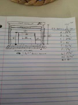

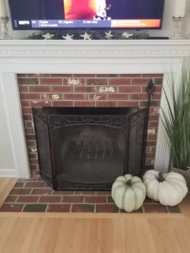

Hey everyone. So I think I'm going to move forward with installing a wood insert into my fireplace to try and get some useful heat out if it . I've been looking at the Osburn 2000 and the Englander 13NCI to name a couple. I've attached pictures of what I have to work with, but I keep running in to clearance issues with the hearth depth/height. Being pretty much flush with the wood floor I need a much longer hearth or I would need to build it up (not an option really). Just trying to see if anyone with similar specs had some successful installs or some insight on what inserts would work well. House was built mid 90's with recent updated windows. Insert would be used as supplemental heat as I have an oil furnace with baseboard heat right now. Just looking for something with a nice look and viewing window, but not trying to break the bank either. Thanks in advance!

I'll give no advice on insert as I am currently doing research myself....
But, I want to thank you for a very competent drawing with all the measurements needed!!

If the front only needs ember protection you could cover the whole current brick on the floor and extend it out the appropriate amount with a large piece or two of 3/4-1” thick bluestone. It will be raised up off the floor and not recessed like the current brick but you can use some 1/4 round trim stained to match the floor around it. I’m guessing you only need 16” in front of the door so you wouldn’t need huge pieces if you do it as two pieces.
How deep is the fireplace? If it's deeper than 18" and you are on a budget, consider the Century 2900 insert too. It's made by SBI and a value version of the Osburn like Drolet. Another choice is the True North TN20 insert.

Yeah I considered those stoves, unfortunately with the level hearth/floor I would have to extend it out anywhere between 3-7 inches which I really dont want to do. I may be stuck going with a smaller unit.
