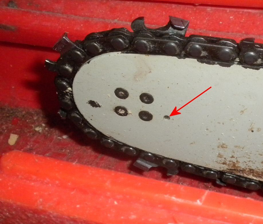

    Here's the tip of my bar:
    [IMG]
    I assume that's a lube port that the arrow is pointing to. Is there any way for me to get grease in there effectively without a special grease gun??

    I just keep pressing grease in with my fingers and spin the sprocket every other press. You can see it working. Yes, it is more laborious than one of those little grease gadgets, but has worked for me.
    I bit similar to the old way of packing grease into a wheel bearing using the palm of your hand......the way your dad/grandad showed you years ago. (I guess)

    I just use the Oregon grease gun... it was less than $9 at TSC....

    Yeah, the guns are cheap. Or they sell adapters for regular grease guns that are inexpensive as well. Works much better than your finger too.

    Stihl bars were not designed to be greased. If they're locking up, usually the chain has been run very loose or the sprocket is not getting enough oil.
    As far as drilling your hole, doing so and not leaving a burr on the inside, not hitting the sprocket/bearing itself, or dropping metal shavings into the hole is going to be a challenge.

    the 'conventional wisdom' is to grease, or not grease, but don't change. Grease forms a dam around the sprocket bearings and prevents bar oil from getting in there, so you need to keep greasing.
    Stihl deleted the holes, on the theory that more dirt comes in the hole, and by preventing greasing the bar oil gets there.
    I am in the 'no grease' camp, whether convinced by facts or by laziness. Clean everything up with ether/starting fluid, dry everything. Don't spin a dry sprocket with air. Then flood it with bar oil, spin the sprocket to work it in, and after that let the bar oiler do its thing. I tend to run rich on the bar oil, keep the chain pins flooded. The old adage 'bar oil is cheaper than bars and chains' is not really true. How many gallons of bar oil do you use in life of a bar and chain....a lot. but I just feel better with moving parts with plenty of bar lube in those pin joints.
