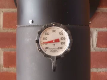

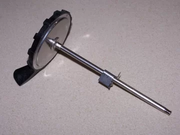

    I use this on my double wall pipe for both my stoves. Works great, no magnet to worry about , clip mounts to 1/4 hole you drill. Probe slides into bracket. Nice interference fit. Stays put. Gauge can be calibrated by just immersing the probe in boiling water. Comes with instructions, Easy to read from across the room at a quick glance. This gauge is part of an oil furnace test kit. Usually over 100 dollars. Cheapest price I found.

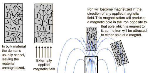

    However, it is well known that heat causes magnets to lose the orientation of the domains which made them a magnet in the first place.
    Here's a visual: http://hyperphysics.phy-astr.gsu.edu/hbase/solids/imgsol/domain.gif
    [IMG]
    Under extreme heat, I've seen magnets lose virtually all of their magnetic properties, but gain some back once cooled, however, not as much as they had to start with.
    This is the reason that most magnetic thermometers that are meant to be used on a chimney pipe (and not set flat on a stove top) are meant to either have a screw placed through them or else a piece of wire secured to each side of the thermometer and around the stove pipe. That way, if things were to get too hot, you don't have to worry about the thermometer falling off, landing on your foot, carpet, hardwood floor, cat, dog, or anything else in the house you don't want to have a nice burn mark on.
