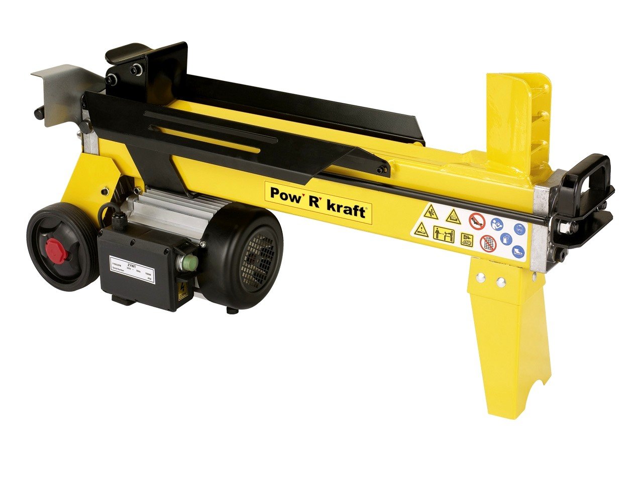

    Ja, but it won't go vertical. BWS can make all his kin'lin with his splitter vertical. I went looking for his how-to but found this instead.
    [IMG]
