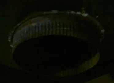

I have an 8" Metalbestos ceiling adapter that I need to connect the new stove to. I was told that I can only use Selkirk double wall to connect the stove to it? Is this right? Isn't the ceiling side of a ceiling adapter generic?
Who told you that? A Metalbestos vendor?
As long as you have the correct flue extension from your ceiling
support box, you can use any double-wall that fits.
I was trying to get a quote for Simpson. They wouldn't quote it because they said it wouldn't work. I understand the chimney side but I don't understand how the ceiling side can be incompatible.
