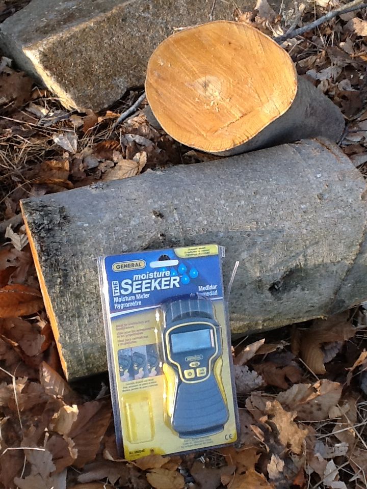

    I just bought a moisture meter. The brand is "General." I was playing with it today and have a couple questions.
    I ran out of "good" wood a few weeks ago. So now I am burning stuff that isn't as seasoned as I'd like. The MM says that it is around 18-20%. So according to that, it's not as bad as I thought.
    But then today I was splitting wood for next year that came from a tree I just cut down 2 days ago. It's a light wood, easy to split (sorry I don't know my trees - but it's not an evergreen...ash maybe?). I tested that wood and it rang up 25-26% on the meter. I was expecting it to be much higher. Maybe because the growing season hasn't started yet?
    So, since that green wood was only 25ish, and I know it's green, the 20% wood that I'm burning now doesn't make me feel very good. I wonder if this meter typically gives low numbers and I should really be shooting for the 10-15% range.
    What do you guys think?
    Btw- I'm testing the wood the right way...by splitting a split and placing the prongs along the same grain.

    It split really easy. No struggle at all with my maul.
    Here's some pics. This is the wood with the meter

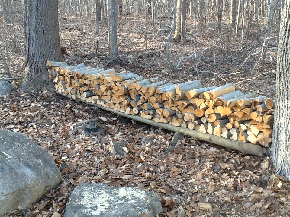

    This is the start of my stack. It's in direct sunlight all day, so it will remain here all summer. I'll move it to the wood shed in the fall.

    The reading on the MM is not an absolute. It is a guide. Leaf is red oak and beech.

    Also those MM are calibrated for temps in the 70s so they will read different at colder temps. I believe they read lower with colder temps.
