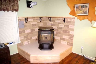

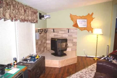

I Bought 2 used stoves, one came with a Hearth Pad. I built a new raised Hearth for one and did some other remodeling in the family room to accomodate the new (to us) stove.
My total cost for 2 stoves, the pipe, the Hearth and the remodel of the corner in the family room di not even come close to 1/2 the cost of a modest new stove.
Here is a Piccy of our Whitfield in the family room. The stove, the raised hearth, the decorative wall treatment and the Mantle/shelf cost about $500 total.
This stove will heat the 2400 feet well unless the temps drop below 30F Then we fire the little whitfield up.
Now keep in mind, I never run either stove above the low setting and I burn nut shells.
Just some ideas
Good luck on your quest.
Snowy
