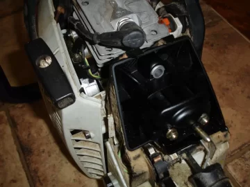

Is the lead that blocky, hard plastic thing that plugs in the top?
Gonna have to get me a picture to be sure. Ignition kill lead should be a slender terminal that is attached to a wire coming directly from the switch. You could have a later model MS280 as well with the electronically adjusted carb. In that case, I can't cite exactly what you should pull apart with a pic. There would be a couple extra wires with that system for sure.
Thanks for your help. Here's a pic:
MS280 - no spark
That is indeed the kill lead.
