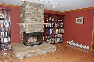

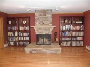

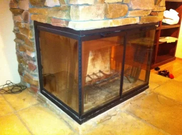

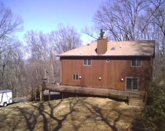

    new to me house has this fireplace. can anybody tell me anything specific about it? how much can i expect it to supplement the oil burner? it has vents inside the bottom that i am hoping pull air from outside to feed fire. located in a central room with stairs to second floor and adjacent to vaulted ceiling living room with loft to second floor. previous owner stated they used it once or twice a year. this looks to be accurate as there is no heat tarnishing or creosote buildup. since it is original to the 25 year old house, should i get it inspected even though it has no use? i dont know how well you can see in the pictures, but the outside metal is kind of rusty. thanks in advance!

    Lots of variables and I am no expert but certainly feel a good inspection and cleaning of the chimney is in order to reveal any issues. Unused chimneys can have birds/bees/critter nests, show signs of wear and such from the house settling and other potential issues.
    As far as the fireplace it does not look to be a super eficient model and is a bit dated so pound for pound it will not produce the heat that a insert or free standing model would but it will offset the heat bill and offer nice fire views.
    Going forward and after the chimney inspection by yourself or a pro you would benefit from potentially a chimney liner and stove upgrade depending on your ultimate goal.

    Nice looking hearth, but possibly a heat robbing monster. I wouldn't expect much from it, just nice aesthetics. Nice view of a fire really.
    Always get it inspected, never know if owners are telling the truth or what could have happened. Cheap insurance for that nice looking home.

    heat robbing even if it is pulling air from outside? i was at least hoping to get all the stone warmed up and give off some heat.
    being that it is three sided, what sort of options would i have for a stove or an insert?
    ultimate goal is a wood boiler in the barn. trying to get ahead on wood now and maybe an install next summer if funding permits. then this fireplace will be for aesthetics only.

    I don't think that's how fireplaces work. I was surprised to learn ours sucked more heat out of the house than it added. We put in a freestanding stove in front.
  7. begreen Super Moderator
    joined: Nov 18, 2005
    36,118 posts
    South Puget Sound, WA
    Agreed, if the goal is heating I would consider opening up the front and putting a freestanding stove with a full liner in there. What's the opening height?

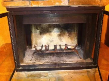

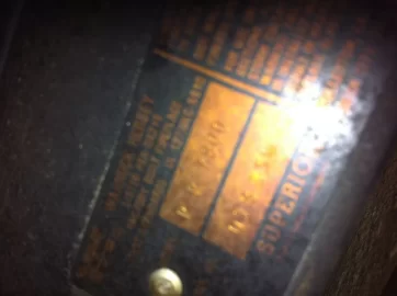

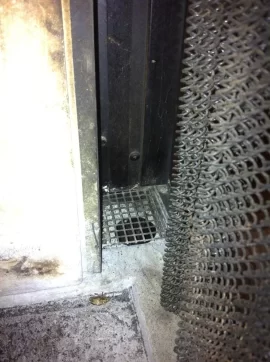

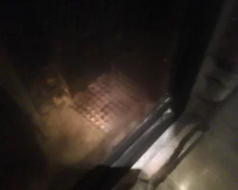

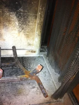

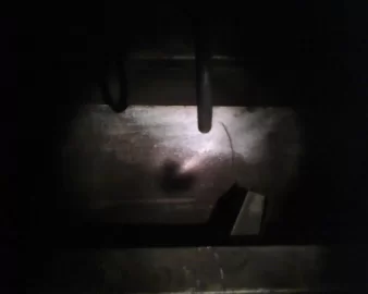

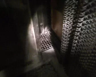

    what i have is a Warnock Hershey Superior PR-7800
    what is with the vents in the back at the bottom?

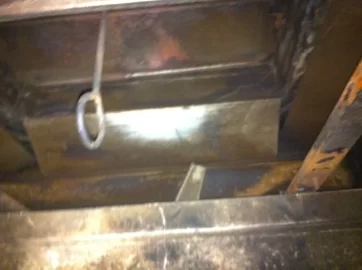

    in the last picture top center is the pull for the damper. then there is a lever in the back that moves side to side. what could this be for?

    disregard the Warnock Hershey part, Warnock-Hersey is a test lab

    I cannot find the manual for the superior PR-7800 three sided units. Can you confirm that is the correct model number?

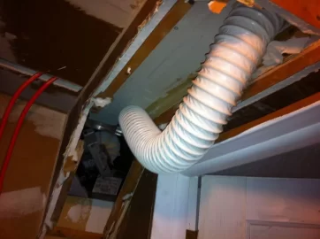

    The other three sided units in the superior line have outside air kits that bring air from outside the house into the fire box. They also have combustion air control levers somewhere just inside the box to control the rate of burn. These sound like the vents and control you have mentioned.
    If the outside air kit (OAK) was installed there should be a 4" diameter or so flexible tube going from the bottom back of the unit to some outside area (maybe crawl space) of your house.
    While the unit is not as efficient as a newer stove/fireplace insert it will be more efficient than an old fashion open fireplace.
    Is it possible to post some larger pictures of the unit from the front with the doors open and closed?

    confirmed: P R 7800

    I would get that setup checked out and start me a fire if all is fine!
    It may do ok seeing the combustion air is from somewhere else besides the living space.
    I sure would give it a shot!

    so there is this fan in the boiler room which happens to be under the fireplace. the home inspector told me that is to kick on when the boiler room gets to hot in the summer. that explainatino never did sit right with me. what if there was a fire and the fan turned on? it would then be feeding the fire more air.
    anyways, i have never noticed it turn on. followed the wire for it to a switch. took switch cover off and it has been disconnected and capped with wire nut. hooked it back up and got fan running. i cannot feel any air movement at those vents in the fireplace. i will trace where the white tubing goes in the ceiling of the basement but i gots a brocken foot currently so i dont know when i will be able to do that. i dont even know if it is but if this is for the fireplace, wouldnt the basement be an inconvienient place to put the switch? wouldnt this blow smoke into the room when reloading?

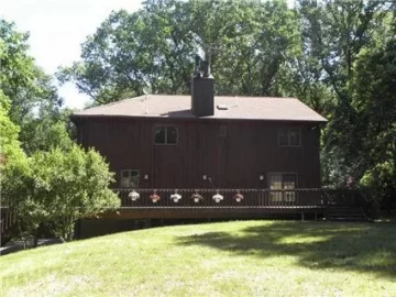

    Judging by the board clad chimney, you don't have a full masonry chimney and fireplace. All of that stone is just fancy chase covering. I suspect you could demo it right to the back of the fireplace...I suspect the balance of the construction there is a chase for two flues coming from the basement?
    The three sided and raised hearth extension is a real space killer. If it were mine, I'd demo everything except a stone clad chase adjacent to the back wall for the other flues. I'd then do a freestanding stove install on a flush or minimal height hearth pad. Perhaps raise the bookcases off the floor and extend the tops to the ceiling with some molding to make them look built in.
    If you are able, it may be worthwhile to get up on the roof and inspect the chimney chase for proper flashing and the condition of the flues and cap area.
