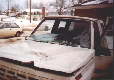

    8 or 10 feet? How about 30 feet? The pic is my car from college, right after a couple hundred pound chunk of ice let go from the roof in the spring. The result of a combination of an old house with no insulation and a freakish UP winter of both extreme cold and lots of snow. I was 10 feet away through the basement wall, it sounded like a bomb.
    I see I'm a little late on this thread, but just wanted to share...
    I see those snow stops here in DC a lot, not sure why since it never snows. I never saw them in the UP; I'm not sure how long they'd survive anyway. People up there just shovel the roof off once or twice. (Not my cheap landlords, of course!)
