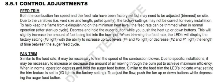

On page 33 and 34.
First, on page 33 they mention a "PRIME" button, if you look at the figure there's no such a button. I dont remember seen this mention when i looked at the manual the last time over a year ago, it's been a year or so and maybe i don't recall......but regardless do you see a "PRIME" button???
My stove does NOT have that button.
I assume they mean the "AUGER FEED" button.
Second, on page 34, the BLOWER TRIM now says it is behind the side panel by the control panel.
Honestly, when i looked at this over a year ago i don't remember mentioning anything like this. I think I'm sure this trim was controlled similar to the FEED TRIM by a combination of buttons.
I'd like to increase the air coming into the burn pot.
