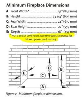

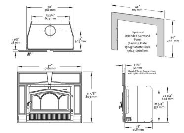

So.... I've done a bunch of looking, measuring etc and I think I've talked myself out of trying to install a stove recessed into our fireplace opening - it's a little too small to really work well. This will be to heat the main floor of our 1800 sqft bungalow.
So, now I've been looking at various inserts and seem to have it narrowed down to these ones:
