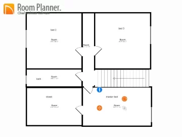

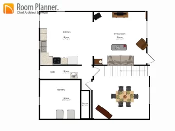

We heat just over 200 sq ft wit a p61a. Does a great job. Stove is in the living room and that room stays between 72-74. Upstairs is 69-71. That's only running it halfway. This winter has been brutal and she kept up just fine. Clean her once a month. Burned almost 6 ton this year, but I'm still saving. Here is my floor plan.

Very happy with this stove, it was a lot up front but it's almost paid for itself.
