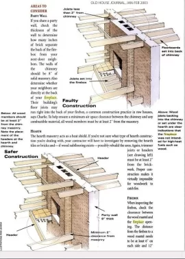

It turns out that my neighbor had his fireplace redone last season by a local contractor. I called them over, and we began investigating the problem. After cutting into my wallboard, it became apparent that the neighbor's fireplace had fully breached our party wall, and was actually resting adjacent to the plaster on our side. Below you can see the concrete back of his fireplace, where we had thought a course of bricks (i.e., my portion of the party wall) should be.
After much back-and-forth, we agreed upon a solution whereby they would replace the back of his fireplace with a single course of firebrick, install some fireproof insulation on our side of the party wall, and then cover it over with wallboard. Notwithstanding my concern that this provided only about 4" of insulation (whereas the code seemed to require 8" of masonry), I agreed to this proposed fix when my own inspector OK'd the plan. Below you can see the wall on my side after the re-bricking, as well as the installation of the insulation, which was adhered to my wall with SmokTite.
However, two days later -- before we had even installed our wallboard -- the wall started getting hot again. I put my digital meat thermometer against the wall, and the temperature readings started rising quickly, eventually settling at 267 degrees, as you can see below. My neighbor adamantly maintains that this is normal. My intuition tells me otherwise. What do you guys think?
