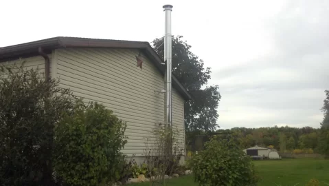

    The offset isnt truly necessary. The eave was 10", so an extra 12" Horizontal section would have given you the 10" + 2" for clearances. I went out about the same amount and only went up 18' (Simpson Triple wall). So your 22' would have drafted fine.
    Here is a pic. I had to make custom brackets (well, a Maintenance man at work did) for the Supports every 4 ft. But it doesn't look to bad. IMO anyways.
    Good luck on the install. Looking forward to pics.

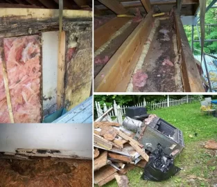

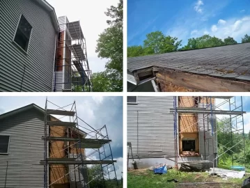

    To follow up on my project. I have attached a few pics of the deterioration, deconstruction, and reconstruction. I moved the hearth from the back to the front of the house and installed the thruwall chimney. I went with Lowes and bought the supervent. I had them price match some of Menards prices. This was the most economical solution. I did have an issue with Lowes but that was their online customer service and a young inexperienced store customer service rep. All in all the management at Lowes resolved the issue.
    One issue that I have with the new chimney is that for the past few weeks I have had a low draft. I started thinking that it was the wet heavy air that we have had. I noticed smoke coming out of the cap so I thought that there was some flow. I cleaned the stove inside and out. Removed all the interior stove pipe and cleaned that out. Checked the exterior clean out (about 1/2 full) and still had a low draft. Smoke was seeping through the stove pipe when the chimney was getting back up to temperature in the mornings. If the stove was below 225 degrees I had issues. I was going to pull the cap this weekend to see if there was a creosote build up at the cap or if the cap wasn't allowing enough air to draft. Last night I was sitting near the stove and I hear a noise in the chimney pipe. I thought it sounded like an animal moving but thought an animal couldn't survive the smoke.
    This morning the stove was running like new. I wondered what the noise was from the night before and checked the clean out. It was full of creosote. I dumped the clean out and found a solid 4" high cylindrical piece of creosote. My assumption is that it built-up at the 15 degree elbow. I know my wood wasn't as dry as it should be. That is because I spent a lot of my wood time fixing my chimney.
    So now I wonder if cutting the eave and removing the elbows would work better. But then I think if the elbows weren't there would the creosote built up at the cap? When I talked to my local installer about the low draft last week he mentioned that the outside chimney has a greater temperature difference and doesn't stay as warm as if it were an interior run. Could the difference in temperature also cause more of a creosote issue?
    Thanks for reading through this message. Any advice would be appreciated. It looks like for about $60 I can buy a chimney sweep kit and could then clean the chimney in the middle of the burning season if needed.
