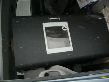

    :) now the work begins. a thorough cleaning will be in the cards. will put away for a warmer day to get at it. a pic to confirm it did happen. there will be questions posted in the near future(dexter & amc343). it's a manual lighting model #2248.

  2. 343amc
    343amc
    Feeling the Heat 2.
    Nov 23, 2005
    375
    181
    West Michigan
    Congrats and welcome to the furnace family. Hope it works out well for you.
    Handy hint while its not in your house - clean the heck out of it. I'd blown mine out with the air compressor, but didn't get behind the "back wall" where all the real crud was. I wish I'd hit that area with the compressor before I brought it into the house.
