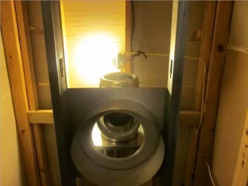

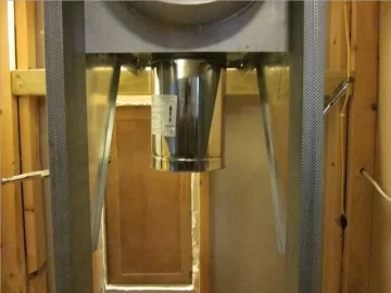

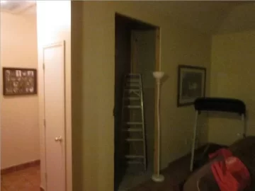

What I have done so far: I removed the fireplace (builder’s model) and the chimney flue, see photos. I have also installed Selrick 6” stove pipe and a wall support kit in the enclosure. The pipe goes all the way through the attic and out through the roof (see photo). I have followed the clearances of the Selrick stove pipe. Actually the only place where the pipe is even close to a combustible is where it goes from the enclosure through the ceiling and to the attic to the enclosure on the roof. Also, the plan is to set the stove in the living room and within the clearances specified by the manufacturer. In other words, at least, 18" away from the wall. I am not sure if I will use manufactured stone or tile. I have also read the posts about Hardibacker, but I believe that since I will adhere to the clearances, I should be okay. Any tips on this area are also welcome.

• I also e-mailed a Selrick representative and he gave me the go ahead on the wall support kit in the enclosure. I would like some input from some of the professionals on this forum. I am also concerned about a possible draft problem? I say this because as you can see on the photos that there will be about a 2’ horizontal part. I foresee about a 1’ vertical going from the stove with a 90 that goes horizontal (24") into the “T” (wall support) and then goes about 18’ up through the ceiling and attic and ultimately outside the house. Could I have a draft issue? Should I line the inside of the enclosure with corrugated sheet metal instead of having the studs exposed? I happen to have plenty of that laying around. I know this may be overkill, but thought I would ask.
