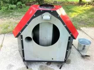

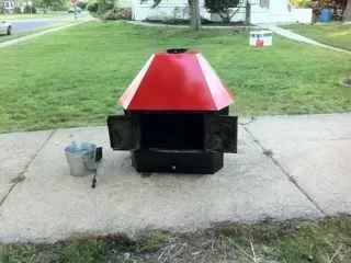

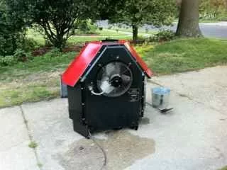

I bough a sheet metal wood stove that I did my best to work with, last year, but I know now that I need something with some more substance for this year.
