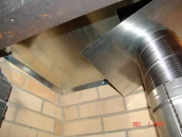

but do you have a block off plate??? that will increase heat output
https://www.hearth.com/econtent/index.php/articles/making_a_block_off_plate/
and pics of what it looks like this was mine being put in

The key question is the block off plate that Begreen asked. This is the one you didn't answer. Your draft may be good but,
without a block off plate maybe you are also loosing your heat up the outside off your liner. There is lots of threads about block off plates. edit; iceman ya beat me to it....
