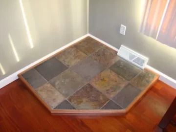

Total cost $85 bucks. Knowing I saved $300+ Priceless!!
Materials used
2 layers of 3/4" cdx plywood
1 layer of 3/8" Durarock
1 layer of slate tiles
Wrapped in Mahogany
Total height 2 3/8"
3 hours from start to finish
Let me know what you guys think something like this is worth. I own a custom cabinet shop and was thinking of making these to sell. Thanks
