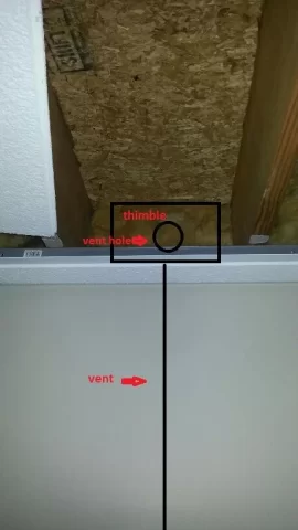

The hole you're proposing to cut in the joist is an absolute no no. If you're going to have it inspected it will not pass. The hole in the concrete is the better option.
I took my basement window out,put up plywood and insulation and installed where window used to be.I have 3 more windows so I still get the outdoor light.
From your pictures the joist run left to right which tells me the left and right walls are bearing. Could you locate the stove on a left or right wall? If so then you can vent in between joist spaces and would only be going thru a band board that ties into all of the joist ends. You could rent a medium sized hammer drill and a long bit. Most poured foundations are 8" thick. Draw your circle and run around it drilling holes and then knock out the chunk in the center with a hammer and chisel. That would be a bit of a chore but could be done. Most hammer drills also have a chipping hammer mode and misc. bits to chip out the piece you want out also.

I was just thinking a few hours ago, why not just put this on another wall where a joist won't be in the way. I would rather have it on the wall I original picked out because I wanted it there and it would be facing the east and most of the time don't get a east wind. plus the ground and area has less combustion around.

Ask any questions you have. I'm a contractor and will gladly help. I used the multi tool doing mine. I have an expensive one I used to do certain things with and I also have a cheap one from Harbor Freight that I don't care if it gets muddy or dropped. It works well also. They have a few to pick from there $19-$39 bucks. They come in very handy for a lot of stuff with blades to cut anything you want.
That's what I used cutting mine in Oct 18th. Depending on your thimble and hole the multi tool or hole saw would be my weapon of choice. A Sawzall (reciprocating saw) will also work but you will get a much cleaner cut with the multi or holesaw. The larger hole saws will cost as much as the HF multi tool too if you do not have one. I used the multi tool because my wall kit did both exhaust and outside air and required a 7 1/4" - 7 1/2" square opening. Some kits are square while others are round.

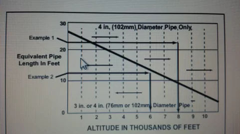

I am a little confused looking at the directions for the install of the vent. I am not sure if I should use 3 or 4inch. It says it goes by altitude. Online is saying altitude is the same as elevation?
My vent will be
one tee/clean out
6 ft vertical
one 90 elbow
3 ft horizontal
then termination cap
If I'm reading the graph correctly, you extrapolate vertically from just left of the 1 (800 ft). According to that graph, your evl can exceed 20 before you need to go to 4" pipe. I think most stoves require 4" pipe if the evl exceeds 15 ft. I think your evl is 5 + 5 (90 deg and the T) + 3 (vert) + 3 = 16 ft evl.
