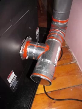

I am putting a layer of silicone gasket material around the tee cap joint held in place with an O-ring clamp. This will allow removal of the cap for cleaning.
i did seal up the joints i only have two in the house. i think the 45 elbow is leaking at the manufactured seam
Inspect at night, lights off, with a flashlight. You'll likely need to seal each joint. Use hvac aluminum tape or high temp silicone. I assume you are using Duravent? Stuff is crap, not your fault.
Duravent user here and I sealed everything including the seams.
