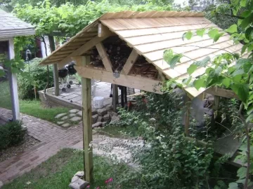

    Well, since this thread is still alive, here are a few pics of the roof. Pt corner posts, kild dried 2 x 4 rafters, and 1 x 3 strapping with white cedar shingle roof. I still need to cut the overlap on the top course and finish a custom venting cupola with ridge cap boards on each side of it. The weather is so unpredictable to finish it off, so it sits idle. I nailed a cut sapling to train a vine up the right front post to hopefully cover the corner and train it across the front. The plantings will fill in even more over the summer. I may incorporate some sort of slat bench to sit and feed the oven on the right side, or even a bench swing on chains. A five gallon bucket to sit on does not cut it. Besides bucket-butt hurts after a while of sitting there.

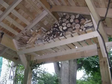

    Detail shot of overhead wood storage that I built up. It holds about eight 5 gallon buckets of wood up there. All high and dry and the heat from the oven helps it along even more.

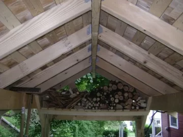

    Rafter detail shot, still need collar ties before climbing the roof for the cupola.

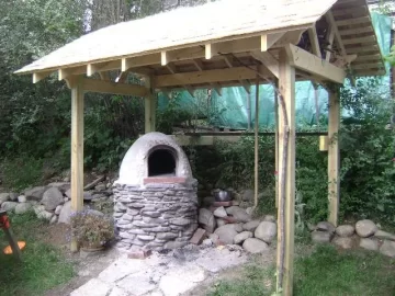

    View coming down from the neighbors yard. I tried to keep it as appeasing as I could to blend in with our plantings. DSC01701.JPG

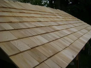

    Detail shot of the cedar shingle roof. By far the best part of the whole process. It brought me right back to when I was a kid and my dad was shingling his house. There is something about working with shingles and smelling the fresh cedar. I cheaped out an bought the "C" grade shingles. There were not re-cut and re-butted. There were a few with knots that will be kindling. If I had to do it again, I would spring for the "A" or "B" grade. I did a bit of edge hand-planing on the shingles to get them square. The shingles are neat to watch as they swell on rainy days and shrink and dry on sunny days. They should last many years nailed to strapping receiving excellent air ventilation.

    Jon only one thing I will suggest and that is to seal that white cedar roof as it doesn't have the rot resistance of red cedar..
    Ray

    Ray, did you use a product on your roof? This roof gets full afternoon sun exposure. It is so clean and fresh, I will miss it when it grays out.

    My red cedar is unfinished and pretty much vertical. On the north shaded side moss grew like crazy and I got the house powerwashed. I would think a good stain sealer would look good but you will need to reapply every couple years after cleaning it.. Guess you better research what works best and lasts longest.. Good Luck!
