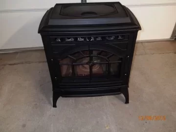

    Bought a new to me Quad Mt Vernon today. It's an early 2006 model...apparently just before the AE came out. The stove was only used for 4 seasons and it's been sitting, hooked up, ever since.
    After a 3hr drive I was anxious to go through this thing and see it run. The gentleman was very friendly and helpful and understanding that I needed to see it run and put it through it's paces. After a good inspection for any cracks in the cast, including the pot, he fired it up. She fired on the first try and everything worked great. Great flame, incredible heat...now I understand the saying "Nothing burns like a Quad".

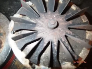

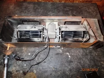

    After the transaction, we loaded her up and spend another 3hrs on the road and set her in the garage for a good break down and going over. The convection blower had some dust bunnies but not too horrible I don't think. The combustion blower was replaced and used one season. It had lots of rust in the housing and on the blade. I've been scrubbing the heck out of it with a wire brush and penetrating oil. It's getting there. The exhaust path had some dust and rust but cleaned up well. All in all she's in pretty good shape. Some more elbow grease and a few gaskets and she should be set.

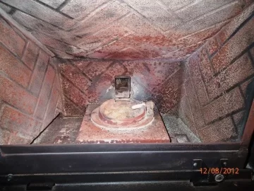

    I have one recessed socket head cap screw that holds the cast iron fire pot panels in place that has a rounded out head. I think I'm going to try to weld an allen wrench into it and see if it'll turn out. These cast iron panels have some rust too, but I figure they should clean up pretty well with a wire brush. Should I paint them? High temp black?

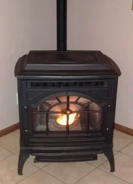

    This little beauty will be replacing the CPM in the dining room.

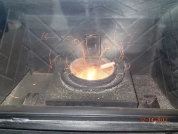

    New thermocouple arrived today and she's up and running like a champ. The old one was really shot...all brittle and falling apart...and I was pretty rough on it when removing the burn pot. Anyway, here's a quick pic of it burning on low right after start up. She really ejects the ash from the pot.
