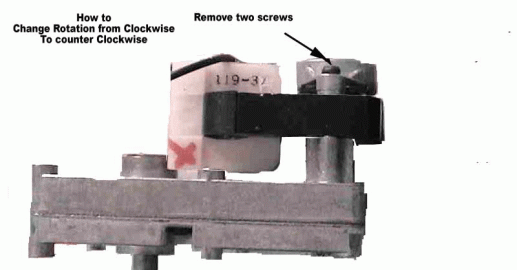

I picked up a 2007 model Englander 25PDV used off of craigslist for $500.00 (A steal in my book) The guy I got it from was a super great fella, 100% upfront with me to the letter. He told me it needed an Auger motor so I took it home and got to doing my homework. Found the motors on the Englander site for $130.00. I also found TONS of complaints about the stock motor. So I decided to find a better motor. I realize im not the first to take on this quest, I found several options but everyone had to be ordered. Patience is virtue but im not very virtuis (sp?). I stumbled onto a guy that mentioned Grainger had a motor to the correct specs but also said it did not work out for him. hmmmm I wonder why? he hadnt really said. All I could assume was the Grainger advertised motor spins clockwise which is backwards for the stove. I went ahead even with the warning and got the gearmotor. I pulled the 2 screws from the new motor stator, then pulled the winding off, flipped the windding over and reassembled. Works perfect. Its a Dayton motor model #1LNG2. Grainger stocks them for $89.00. Great deal, stout motor, And no wait.

I went with the Grainger / Dayton motor model #1LNG2 as well. The reviews on Gleason almost made me pull the trigger on that one, but I went with the Grainger for the sole reason that for a couple of extra bucks (112 out the door) I was able to purchase the extended 2 year warranty in addition to Graingers 1 year, for a total of 3 years. Just made sense to me to have that guarantee so I dont have to worry about another auger motor for a while.
And I did the Flip to, here is a Nice animation from Moderator "hearthtools" from this post here https://www.hearth.com/econtent/index.php/forums/viewthread/52492/
fourth comment in the thread. Its his animation NOT MINE, I'm just Borrowing it because its very cool and simple to understand (thanks Hearthtools)
