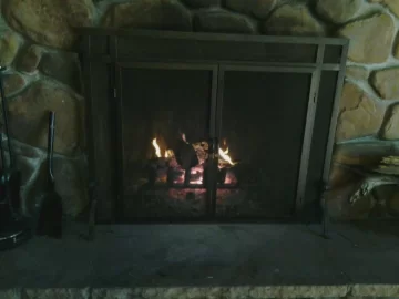

    begreen, here is a picture of the fireplace. The hearth extends 18" out. Thanks, Dan

    Nice hearth. Is this raised above the floor by several inches?
  14. Trooper
    Trooper
    Guest 2.
    Yes. I'm not there right now to measure, but I have somewhere between 6 and 12 inches from floor to hearth.

    Sounds good. I don't think you would need anymore than an ember shield on the floor.
