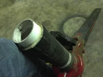

I used a 4"-3" PVC reducer. It goes on over 3" or slips inside 4" (Simpson is all I have on anything). Stills needs taped (IMO) for a good seal. And I support the blower and run it the entire time I clean the stove (every ton). Remember to unhook vacuum line before turning on leafblower (some dont and have no issues).
Edit: Pic added.
