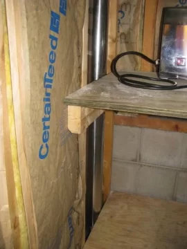

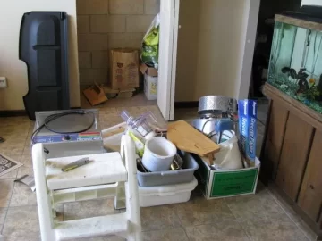

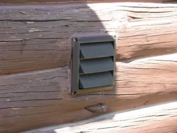

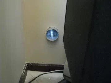

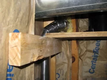

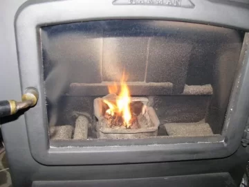

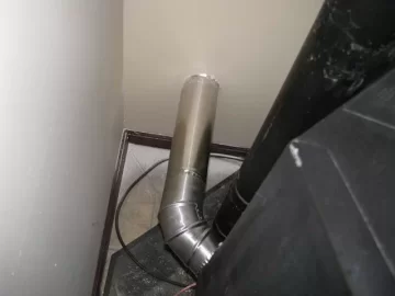

    I decided it was time to put an OAK on the stove after reading about the benifits. Not a tough job except for cleaning out the storage area to get to where I needed to be. I did end up with 1 more elbow than I thought I would need. 7 foot of 3" pipe 4 elbows. Will that be to restrictive? The inlet on my PC45 is only about 2 1/2" the short test burn looked normal to me.

    Good work Neil. I say it'll be fine.

    What did you use from the venting to the Harman?

    I just ran the 3" all the way. I slit it in multiple places and put a automotive hose clamp around it. Touched up with a little high temp silcone. Seems pretty airtight. The 3" vent is a tight fit in the back panel but since the hole is 3 sided it works.

    I might have to see if I can do that, I used automotive flexible hose, I didn't think 3" would fit in the sheet metal gap on my 68, and didn't want to cut it.

    I just came home with a 3" rigid style dryer vent for my P68 and I can tell you it would not fit past the sheet metal cover. Thinking my next stop might be an automotive store or the right pipe online if it can be found.

    I'm not sure if they changed the back panel on newer P68 and 45's mine is an old model. All I had to do to get it to fit was squeeze it about a half inch. I did use aluminum vent which makes it easier.

    Hey Mighty, what size auto hose did you use on your 68? Thought I finally had what i need 2 3/8ID (60mm) flex hose from auto store and it's way to small it fits inside the intake with some wiggle room.
    Thought the box could have been labeled wrong but it measures correctly.

    I used a 3" hose, and it bent through the Harman sheet metal nicely. Rated up to 1,000F. Crimped it on with a hose clamp, and foil tape.
    You could in theory just use a dryer hose, as they are rated in the 400-600F area as well. More prone to breakage though.

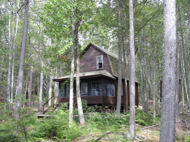

    This is a cabin.
