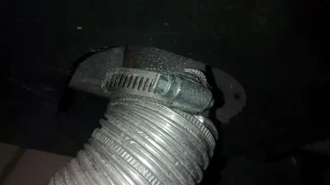

I stressed about this for over a week when I first hooked up my stove, someone suggested to just squish it. Then I realized nobody is going to see this so why does it have to look pretty, I just put a hose clamp on and squished it down, haven't looked back since!

I would agree with you if it was on the exhaust side, but you can bend that flex with your finger, so once the clamp is tightened it's done. What could you possibly benefit by adding a 1/8" thick reducer?
