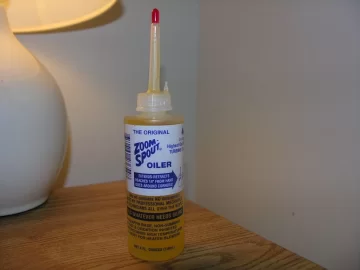

Found this oil at Ace Hardware for less then 3 bucks last weekend while seaching for spray graphite.Ive found a couple old posts about using this product on their electric motors and cant wait to try it. From rebuilding forks on motorcycles I know most automatic trans fluid is a 5w oil.Not sure how thick this Norvey turbine oil is,maybe someone will chime in..I listened to the fire gods and used 3in1 this year,worked very well.
