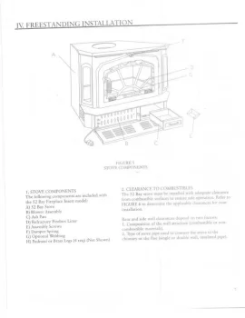

Here is my stove, the new stove and a page out of the manual. I guess the brick are lined right from the drawing.

Oh guy by the way I have looked at the manual and it looks to me it is the same stove,same measurement, same catalyst lay out. the only difference is door has webbing, arch and 2 draft controls. The draft control on my has been moved under the door on the new stove. The blower air come out the top of the stoves on both models. And the new stove has a hole for a catalyst thermometer. Now if their had problems out of my model with draft way not just make a new door to help the draft flow. I now I would be upset if I had payed $2000 for a wood stove and find out it had draft problems and they just made a new stove to fix the problems and not give tech support for their older models. So I guess that in my mind I see a draft problem with my stove. So to fix the problem I wish Appalachian would have a upgrade door fix for my Stove. How much Chimney pipe are how tall of a chimney do I need to fix my draft problem to get the draft air to flow right in my stove. If I had really good dry wood it burn good a hot. So just as soon as I get the money I am going to buy a new stove.
