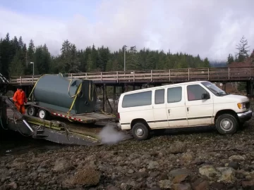

  10. http://www.woodheating.ca/ This company has sold boilers all over the province. If you were to contact Gord, the owner, he would be more than happy to let you know of units he has sold in your area and would arrange for you to see them.
    Here he's delivering a Garn to the remote community of Quatsino.
