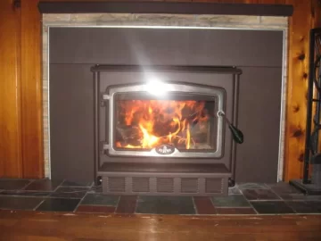

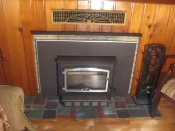

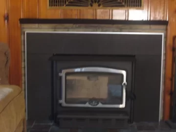

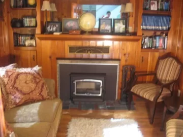

Here are some pics of my Osburn 2000 wood insert I installed this summer with alot of tips from alot of you and I want to thank you all for the help. Its painted Mid Night brown and has the nickle trim package. I also installed a heat shield above the stove because of the wood trim. I do have a hearth extender ordered that will be painted brown as well.
Question: Its going to in the low to mid 50's this weekend in Michigan is this an ok temp to do a couple low temp break in fires?
Thanks again and bring on some cold temps!

Looks great......
It was in the 60's when I installed my 30 last year!!
50's is almost Arctic. Burn away :)
Awesome! Looks great. Congrats. You should be fine to do those break in fires. It's actually good to do it while it's not that cold because the first few fires will stink while curing the paint, so windows open is no big deal.
Agreed!... On both accounts...
Looks great. Congrats!!!
I once did a break in fire when it was 100+ degrees outside, so I think you will be just fine with a couple break in fires at 50 degrees!!!
Looks nice! The chairs by the fire would be nice places to be on a cold night.
Looks great! I am sure that you will enjoy that when the cold temps arrive and the snow is flying.
If it drafts well at 50°-60°… Then lookout when it really gets Cold....!!!
Thanks guys for the feedback. Sure cant wait till this weekend to try her out. That room is the best room in the house and all the company love it, the rest of the house has been remodeled except that room the guy that lived there before me wanted to leave some of the original character of the house and Im glad he did. Its an awsome room to start a fire sit in one of those chairs and have a beer after a long week. You cant see it in the pic but as you enter the room on the right theres a door that goes into our bedroom so our room should get toasty with this bigger insert.
