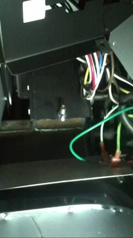

chuckpp said:P61a makes a noise when the arbor turns. It High pitch noise any idears?

I assume you mean "Auger" not "Arbor..."
How old is your unit?
When was the last time you cleaned the
fines collection area in the back?

"fines collection area in the back?"
Where would the fines collection be? Or how to clean it?

bcb1 said:If it is definitely the auger motor making the noise, then the advice I've seen on this board seems solid: take out the auger motor, carefully pull the cover off it and add some grease inside.
I haven't done this on mine since it's a new stove and the dealer is going to swap out my motor. But if it were a couple years old and out of warranty, I'd definitely try greasing up the auger motor before I swapped it out with a new one. Greasing it will only cost a few cents. Replacement motors run $80 to $130.

where the auger enters the tube/gearbox/motor
there is a "box" you can take a nut off and open
it fills with fines from the pellets

I just pulled mine off for the first time (have run only about 40 bags through the stove) and there was about a quarter cup of fines and also about 20 or so pellets. The pellets were in the 1/4" length area. Is this normal?
