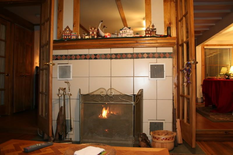

    I opted to tile over the brick, instead of painting. Quite easy to swap it out if you want to.
    Before
    [IMG]
    Pre insert. We took this tile off before the PE was installed
    [IMG]
    PE installed
    [IMG]
    Post PE ... still working on the heatalator vents, which still work.(best pic I have of it, at the moment)
    [IMG]
