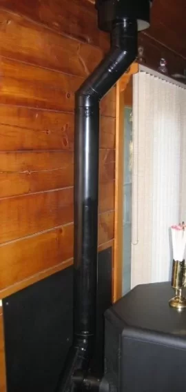

....I was thinking of using a high heat resistant spray paint. Will this kind of paint adhere to the galvanized finish? Do I need to apply an etching primer first?.....
An etching primer isn't needed if you prepare the pipe beforehand.
As I was told by a tech from one of the major pipe manufacturers, the easiest way to prepare the pipe is "pickling" the galvanized. This is simply making a solution of about 50/50 water and white vinegar, and using a rag or sponge, wiping this surface down thoroughly. It will remove any oils, and slightly etch the surface. Rinse completely, and let dry.
You are now ready to paint. I used Rustoleum Hi Heat stove satin paint, and it looked great when I was done....also has never peeled a bit. www.rustoleum.com/CBGProduct.asp?pid=112
Here's mine right after I finished painting & assembly:
