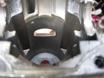

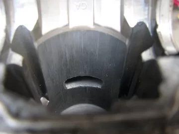

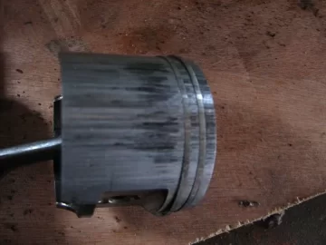

Finally cleared the camera and took some pics. The piston definitely has some scoring and it appears the cyl does too - I can definitely feel it with my finger. The wear just seems to be on one side... weird? One fellow on ebay has a piston/cyl kit for $80, but the desc. says it's aftermarket. Should I be concerned?

Is the scoring on the exhaust side? If so, it was likely straight gassed. If you can catch your nail on the cylinder scratches, I'd be looking at the meteor or NWP kits at Baileys

Yeah, it's scored on the exhaust side. The Baileys website doesn't list a meteor or nwp part for the 290/390, just OEM parts at $267.
