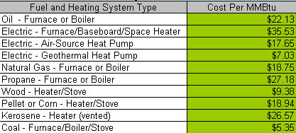

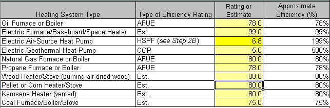

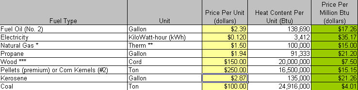

  5. wdc1160 New Member
    I can do better than that your cash flow analysis will nearly match one of mine with a few exceptions. I will make some generalzations.
    This was from 2 years ago, but I have updated some of the numbers-- Bear with me.
    You must know three things to find the variable payback rate (more improtant than fixed cost, fixed is easy)
    I am not really a shoot from the hip guy. Bad calculations end up in bad judgments. So if you need some of the numbers tweaked for your region. Let me know I will correctem. I plan on having a calclator posted online soon.
    Efficiency of appliance
    Cost of fuel
    = cost of 1 million BTU's
    it's good your looking into cash flow -- it is a pillar of modern finance. And, one the best tools for finding oportunity loss.
