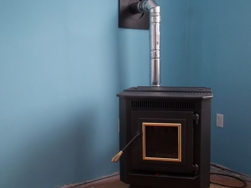

I don't see your venting outside the wall but your eva might be to high for 3" pipe.
Looks like the standard Simpson 3" (3000 kit) vent kit from the Big Box Store. Used the same kit for my Fathers PDV.
Up 3' and out 2', is 13.5 EVL. Any way you configure that kit, it cant go over 15'.
If he goes back up when it goes outside, then yes, he would be over. But going off my memory of his install and pics, its a standard termination out the wall.
