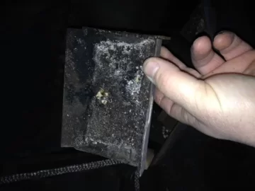

Thanks for the suggestions SteveG &Lake Girl. I came home from work today to this! So I guess my problems are not solved! My stove also seems to be putting in way too many pellets on start up almost fills the pot to the brim. I end up dumping the pot out before it lights and leave a small amount of pellets in there on start up. Is there a way to test the combustion fan it seems like it is running ok? Not doubting your diagnosis Steve you could be right, I just hate guessing and replacing parts that may not be bad. It just seems strange to me that I am having all this trouble since the door gasket was changed. I figured doing that could only help!

Feed that stove a good dose of compressed air or a leaf blower along with a lot of brush work, remove all ash trap covers before doing the torture routine. Be liberal with the hammer against the back walls of the fire box if the fire box is steel. Do not use the thumping routine if the fire box is made of cast as it will break.
Make certain your door is closing against the gasket all the way around and that the gasket doesn't have a gap where the ends meet.
You shouldn't need to run with the damper fully open ever.
do the dollar bill test all around you door with the stove off and cooled down, the bill should have some resistance when closed on it, you use the right size gasket?, should be 1/2" or 5/8"
The fan is likely the culprit, butttttttttttttttttttttttttt, the exhaust fan speed is controlled by the board.
If the Triac on the board is going south the ex fan may not be getting the correct power level, and is running too slow.
If the stove runs fine on medium/high, then its the fan, but why ???
When was the fan motor last OILED ???
These motors usually have two rubber plugs in the motor that when removed allow a couple drops of oil to be placed in there to lube the bushings.
Let us know
Snowy
Agreed with Snowy about the oiling, however now that you say its overfeeding the pot upon start-up, things are leaning more towards the triacs starting to go bad in the board...

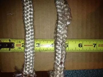

I just looked at the gasket it is 5/8" Imperial brand I purchased it at Lowe`s but it feels a lot softer than the old one that was on there almost has a hollow feel to it. The old gasket looks slightly larger 3/4 maybe? Is this a common size? I wonder if that is my problem since that is when everything started going downhill when I changed the gasket. I tried the dollar bill test in a couple spots but it seemed ok maybe it isnt. I oiled the bushings in the motor last season the motor isnt making any squeals it runs pretty quiet. I hope it`s not the board going bad if that`s the case it may not be worth fixing.

Someone on this board told me that pellet stoves burn hotter, so their door gaskets have graphite in them and they're black... As soon as the weather is mild enough, we're going to replace the door gasket in ours back to factory spec (previous owners put a white one in, and it's not a great seal, but good enough to get us through til I can shut the stove down for 24hrs). I have a Drolet though, not sure if this is standard for other Pellet Stoves. I bought the one that was stated in the manual as the correct replacement. Was about $17CDN plus tax.

You have an air leak… the only thing you changed was the gasket and now you have a problem. That should be the hint.
Early in my pellet stove burning I learned that I had an air leak when I would clean my stove and leave the ash dump rod to the open position on my St Croix. I had the classic symptoms of an air leak… pellets piling up in the burn pot. It happened to me again a few weeks ago…
The soot free glass is also a hint… you now have an unintended air wash.
Yeah I think that is the problem! I do appreciate everyone's input to help me track down the problem. I will be changing the door gasket again. I`ll be bringing both of those pieces of gasket to a stove shop and let them tell me what I need not just getting whatever is on the rack at Lowe`s!
Now how do I fix the air leak but keep the unintended air wash! ==c
