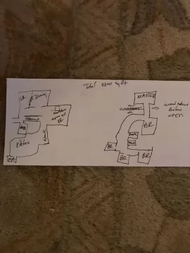

I don't know your stove I have an Explorer 2 and I am heating my house of around 3800sqft to 70-71 with my stove 350 degrees. I have a pretty open set up, but the natural convection works pretty well. My blower on the stove when on you can't feel from very far away. I use poplar, locus and oak. Here is a crude drawing of the floor plan and my stove

Yeah, I think with the open stove design a LOT more heat is radiated back into the room. BTW, when you say you heat your house, are you talking 24/7?

Not 24/7 since I'm not comfortable enough yet running it while not home all day, the FA stuff stays at between 64-65 and I can get the house over 70 in a few hours, I burn over night and nothing else turns on overnight
