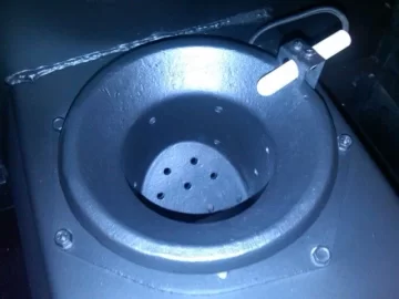

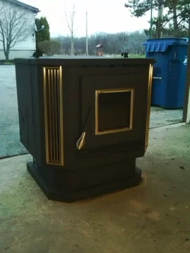

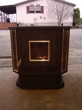

If you are going to replace the gaskets, then I say paint it all (Not the Motors and etc in the back of the unit). I repainted the inside of my Firebox for the 1st time this year. Didnt take me long. I used Rutlands High Temp stove paint.
The only other thing I would do, if you have not already. Is because you have it outside (I hope), I would blast every nook and cranny from the Firebox the Combustion Blower. Take the Blower off (New Gasket needed for this also) and use an air compressor with a nozzle. Also make sure you unhook the vacuum line from the switch, so you dont damage it. I would then clean the Convection blower and check the auger. My Quad has no Oil Ports on the Motors (Factory motors dont/I bought an aftermarket Combustion blower that does), but I still drop some 3-in-1 (Blue Bottle/SAE 20 for electric motors) on the bearings where they are visible. Some oil does get sucked in. Some people do this, some dont. I figure it cant hurt.
Or read this https://www.hearth.com/econtent/index.php/forums/viewthread/75103/ My Spring Cleaning thread.

Thanks for the reply! It's good to see examples of someone else work. I'm working out in my shop, it's got a big garage door on it so I have plenty of ventilation. I'm going piece by piece to make sure there is no rust. Even replacing some of the screws. I've found all the gaskets except for the feed motor. Part # 240-0731. Any idea's on that?

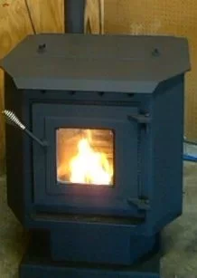

I have used Rutlands Stove Paint and Rustoleums. The Englander of my Fathers and mine (both 25-PDV's) I painted with Rustoleum. They turned out great. I did paint the inside of both them, Dads has not been ran since paint and mine has only been ran a few times. Any inside paint will not last long. It is a very harsh environment inside the stove. As for the outside, it will be fine (either brand). The color varies slightly between brands. The Rustoleum has a real "Dusty" finish. Its a Very Matte finish that seems to lay out a lot of over spray. Rutlands is a little brighter and less over spray.
I have also heard a lot of good things about Stove Bright. Can't really comment because I personally have never used it.
I re-painted my Quad this year (inside) and do not expect it to last a couple weeks.
None of this may have answered your question. Will post pics a little later. So you can see the difference in the "Matte" and "Shiny" paints.
You can see the Rutland on the inside of my Quad (pic also above). Its a shiny, but still dull finish.
The Rustoleum is a Matte/Dull finish that seems kinda "Powdery"..
My Englander and pics of my Fathers. Both are bad pics. But its an idea. You can see there is not as much "Sheen" as the paint on the Quad.

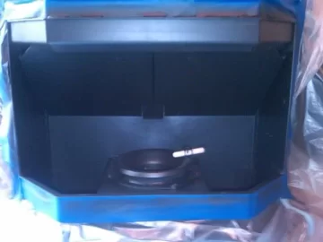

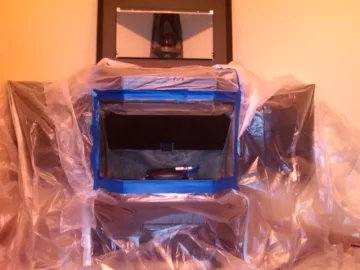

Hey all, thanks a lot for the help! We've started painting the stove with Stove Bright. My brother in law was able to talk to his paint vendor and get a gallon of it, and we're using the HVLP to apply it. It looks amazing! It's just a major pain the butt to keep the rust off of it. I live in Washington, and the air is pretty humid. Rusts at the drop of a hat.
